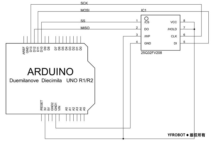

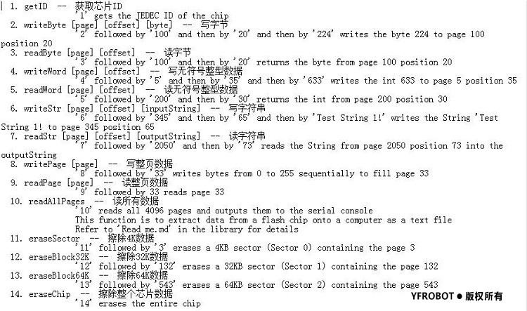

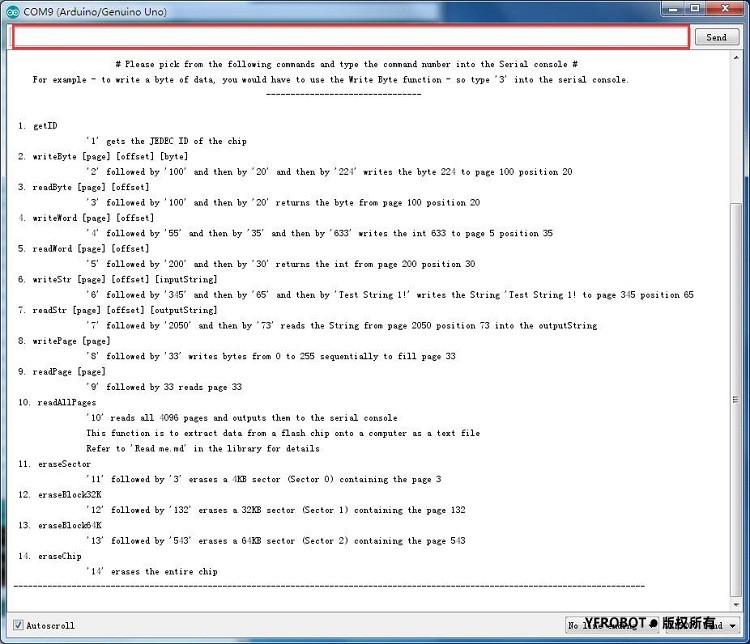

Arduino读写SPI Flash存储芯片 -- W25Q32

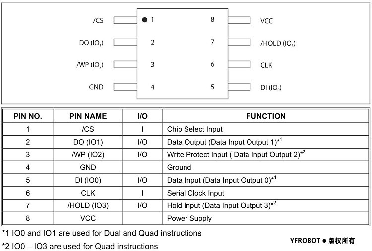

W25Q32BV Datasheet (芯片数据手册):http://wiki.yfrobot.com/datasheet/Winbond-W25Q80_16_32-SPIFlash.pdf
引脚定义:
