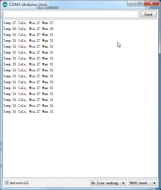

//thermometer - Measuring temperature, record temperature fluctuations int lm35Pin = A0; int temp = 0; int tempMin = 100; int tempMax = -100; void setup() { // put your setup code here, to run once: Serial.begin(9600); } void loop() { // put your main code here, to run repeatedly: for (int i = 0; i <= 9; i++) { int signVal = analogRead(lm35Pin); temp += (signVal * 5 * 100) / 1024; signVal = 0; delay(80); } temp = temp / 10; if (temp > tempMax) { tempMax = temp; } if (temp < tempMin) { tempMin = temp; } Serial.print("Temp:"); Serial.print(temp); Serial.print(" Cels,"); Serial.print(" Min:"); Serial.print(tempMin); Serial.print(" Max:"); Serial.println(tempMax); temp = 0; delay(500); }
程序下载地址:thermometer
- 串口监视结果
