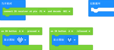

* MakeCode扩展:https://github.com/YFROBOT-TM/pxt-yfrobot-ir
* MakeCode参考程序:https://makecode.microbit.org/_RjLF2kf7u8oh
[[File:Microbit-红外测试.png|400px]]
